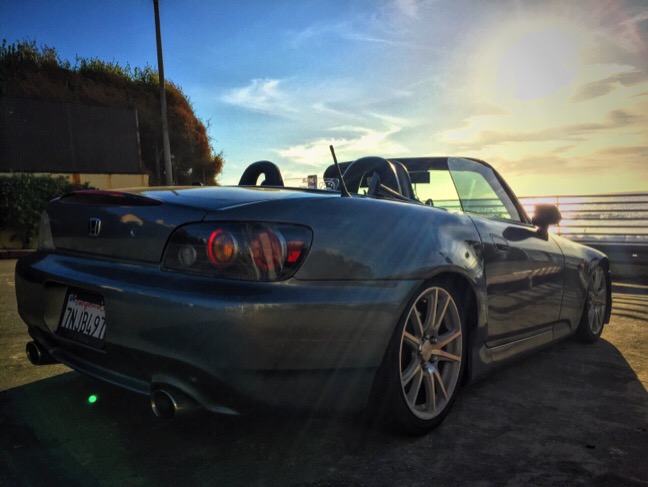

Current fitment I am working on for the S2000 I recently acquired.
17x9.5 +40 Rear with a 255/40/17 RE71R
17x8.5 +40 Front with a 225/45/17 RE71R
Since RE71R supposedly run narrow, I'm not sure if I should attempt to move up in width by 10mm. The car is rolled stock fenders front and rear. Have not relocated the bumper tab yet and the car is not extremely low on PSS9. This is a street/track car, so the PSS9 may be going soon for something more track oriented.
-Ken
