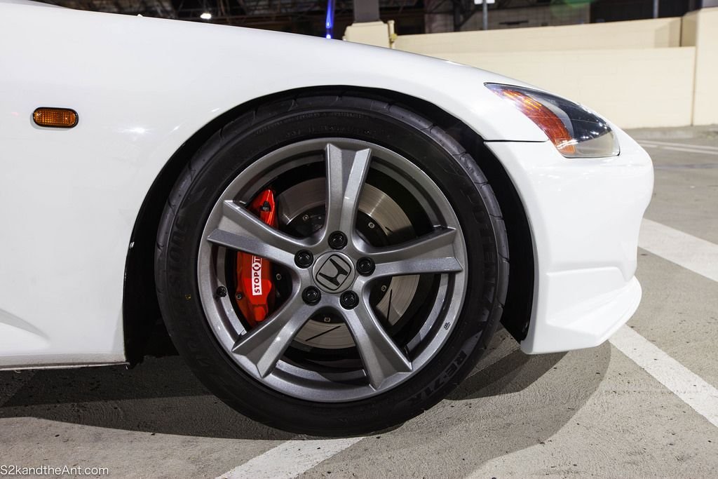

Why don't you get the AP2V3 wheels? Seems to be the 5 spoke look you want and they will actually look stock. A +45 offset will look odd at stock height due to the added poke. And yes the bolt pattern is 5x114.3.

i only like the looks of the ap1 wheels, only reason i want to replace them is because mine came with serious curb rash and it looks awful up close.
