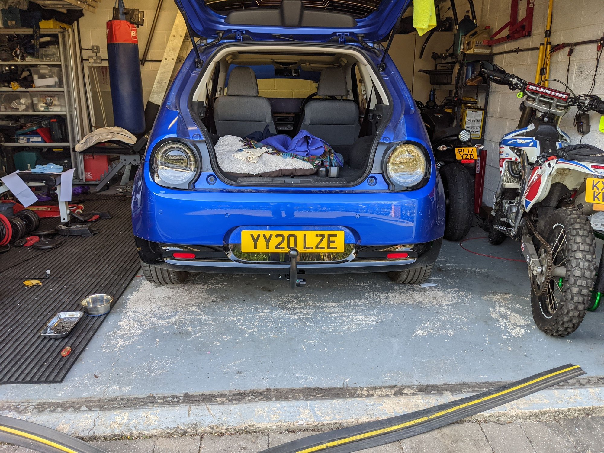

Right.. so I started the physical bit. Not too difficult, only odd bit was having to cut off a couple of bits of metal. The lower, inner brackets fit into subframe sections.
Getting the bumper off the tabs was a bit stressy as it gave no indication on how it came off in the instructions
Very solid. I wonder whether you lose some crumple zone.
wiring next

This is very limited load and you can see why. 3 little bolts each side at the top, one each side clamping each subframe for the lowers and a grip on the rear tow eye
overall a bit of a pain to fit but decent design, loom was easy though not tested yet. The removable tow bar has keys made of cheese.. or a key now
Other than that and some wrong handed instructions all ok. Never a 2.5hr job though
The arduous bits
cutting the rear subframe tabs needs a grinder with cutting disc and touch up paintCutting the bumper is scaryyanking the battery means nowt works, including the frameless window duck.. be aware, get all windows down
other obs.. honda don't paint bits you can't see even worse than they used to
I'm glad it's detachable
pretty it aint

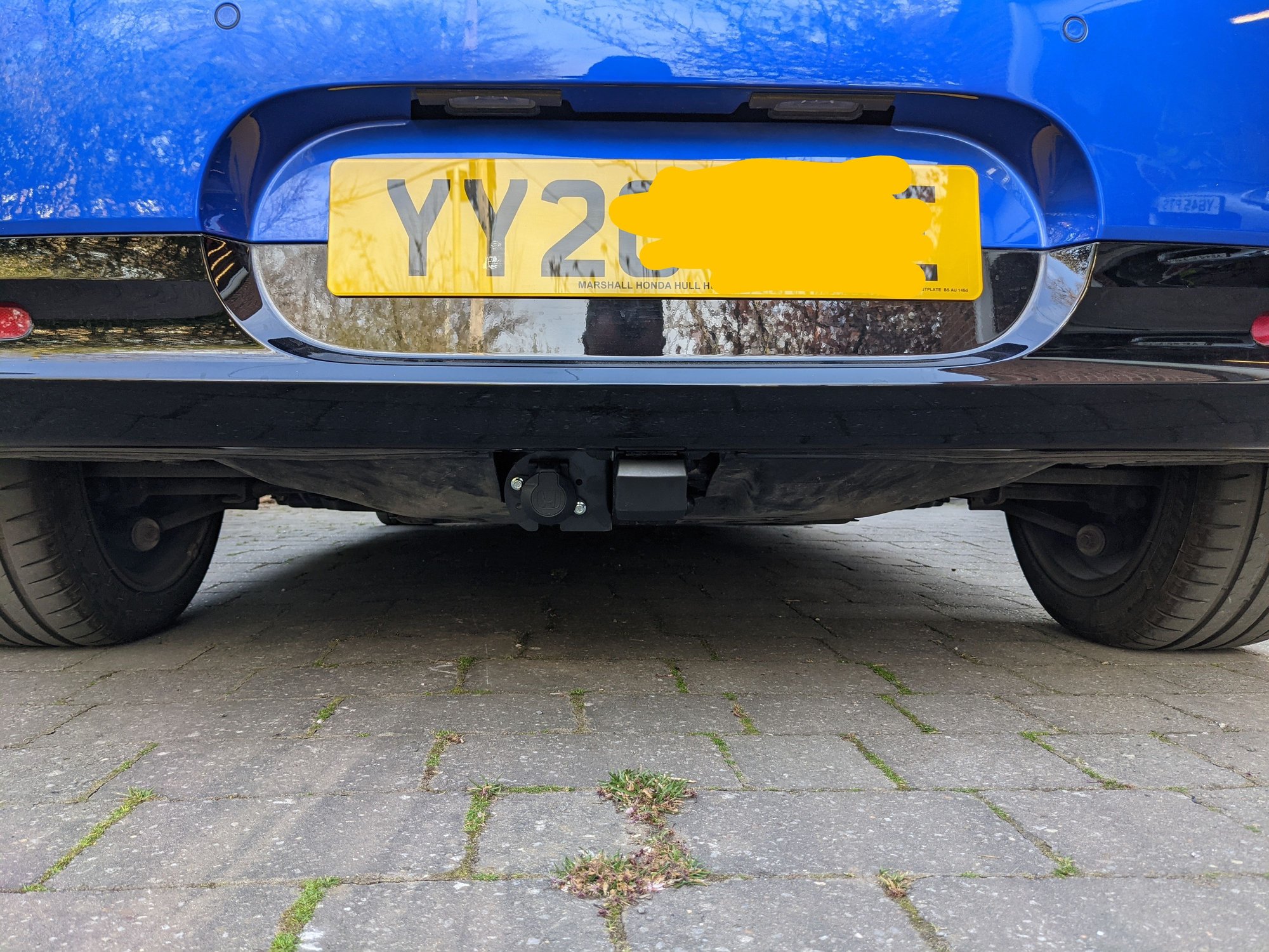

Loom was simple, new fuse, intercept both rear clusters and run the tow loom through a pre existing hole after pulling grommet out
now I just need a rack.. it's subtle once removed, the towbar is a detachable locking thing

Its more sturdy than collapsing tin item so will behave differently I guess but more old skill
Makes sense re fitment but you would not wanna tow anything heavy for sure

That looks very subtle and presume that the bracket/rack/aux number plate will stay on, or will it be fitted every trip?
Am thinking toe rags nicking it while you're parked up. Though there won't be the market doesn't stop tools alas.
