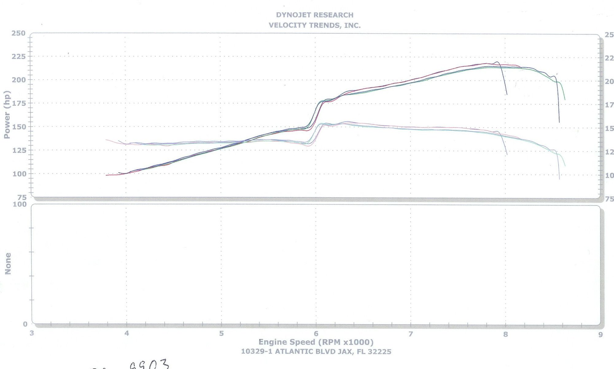

too many different vairiables and it's common to see a +/-5hp on a dyno on different days. Keep it fun and just use it as a guide. anyways here's my dyno, but it looks like I'm going to be bumped off which I should be as I'm practicly stock
