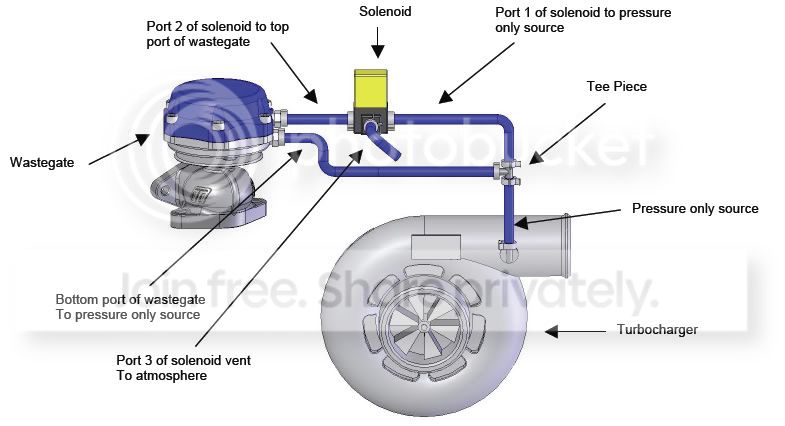

Sorting out my vacuum lines and how to run them....So should I tap my Turbo for a fitting to run a vacuum line to the bottom of my wastegste or can I pull it from manifold? Top port will go to my boost solenoid then solenoid to intake manifold? Then the bov to intake manifold... what's the best way?
You'll want to run your wastegate lines as close to the turbo as possible for faster boost response.

Originally Posted by S2-Kai
This. Either tap the turbo or the charge pipe connecting to the turbo. This is the way I routed my mac solenoid.

Thanks,so I don't need any vacuum line from the intake manifold to the wastegate? Just tap the Turbo and tee it?
Yup! And the vacuum line for the blow off valve is best routed to the intake manifold.
