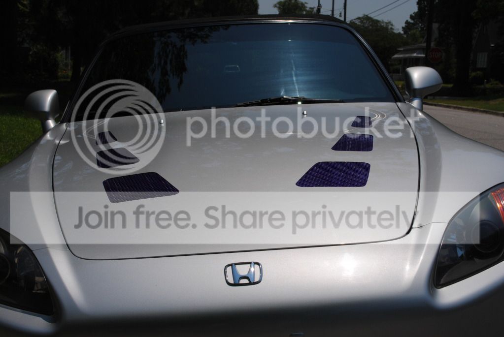

Yeah just looked at the $600 base line and the $1000 top of the line dual pass...I don't want to spend that much, but at the same time I don't want to overheat in a traffic jam if I get caught. Not sure what to do now...
Vent your hood:
http://www.motoiq.com/MagazineArticl...nted-Hood.aspx
Also consider this. Spend an extra $500 now or potentially $5000 later with a blown engine.

Hood is vented.
