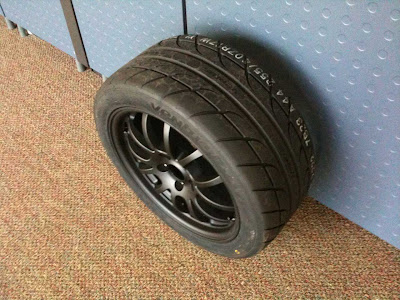

I just installed these and took the S for a spin:
My first impression of the setup was that it is going to need more roll control... BADLY. I'll get the alignment done this week, top off the nitrogen in the shocks, then race it this weekend. I will continue to play with compression and rebound through the week, but I suspect it needs a big front bar or more spring or both. My brain is having trouble comprehending paying $600 for a front bar.
This will be my setup for the first event:
Moton Clubsports
anti-roll bars F/R: stock/none
ride-height F/R: 34cm/34.5cm (13.39"/13.58")
springs F/R: 700#/550#, 7"x2.5" + helpers
toe F/R: 0"/3/16"
camber F/R: 2*/2*

Does anybody else feel like the Hankook has a soft sidewall? It just feels sort of balloon-like when I push my finger into it. It reminds me of a mountain bike tire sidewall. My car rides better (less harsh) with the 17x9s and Hankooks than my stock wheels and RE-050s.
It may not a bad thing, I'm just curious. I've been running almost exclusively Dunlops and Yokohamas for the past three years and they are notorious for really stiff sidewalls.
Old Jun 21, 2010 | 11:53 AM
  #2086
TheNick's Avatar
Joined: Jun 2008
Posts: 1,024
Drive on the Toyo's once - everything will feel like a rock compared to them.
Seriously though - no I don't notice anything soft about the Hankooks. They feel crisper on a 9" wheel than the Dunlop or Bstone ever did on a 8.5" wheel. But thats probably due to the wheel width more than anything else.
