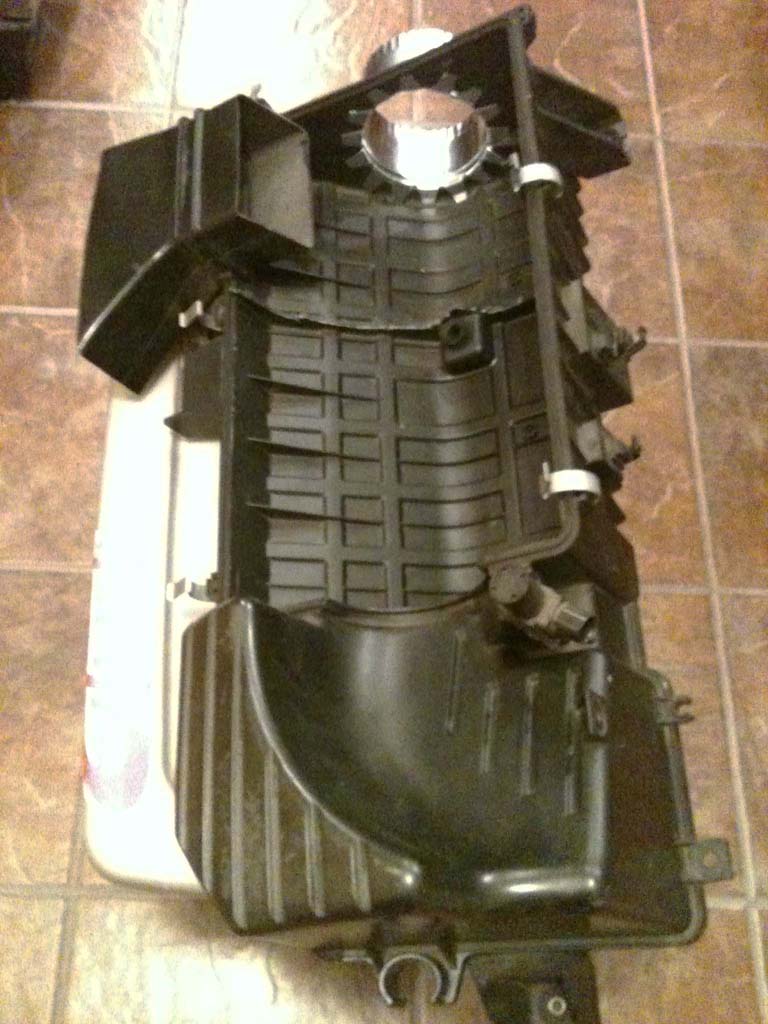

I'm in the process of the recently explored intake mod, and was wondering what purpose the massive box under the intake tube serves (bottom of the pic attached). It only has a small opening into the main intake chamber. Is it purely harmonics? Any reason (performance related) not to remove it and close that small opening?
Other than finding a way to brace that side of the box since the one bolt mount will be lost, it seems like a pretty simple task.

Marks_lude from my understanding it's just a sound tuning thing. You can block/cut it off if you see fit.
Edit- search on here for stock intake mods and you should find pictures of it blocked off
