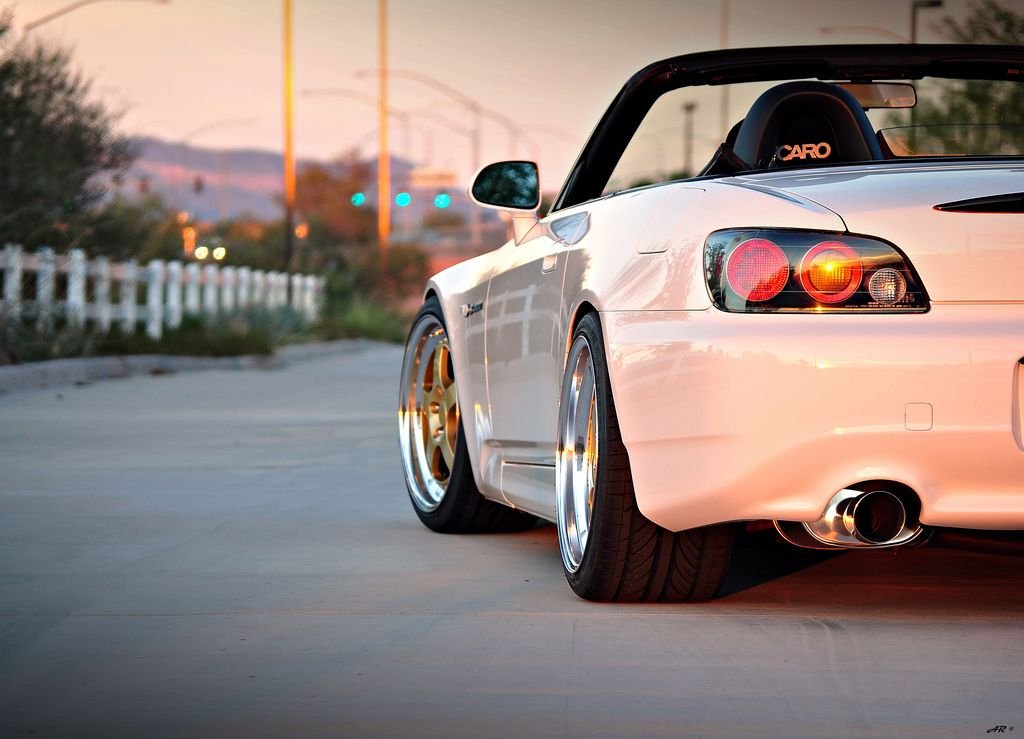

I am running 11" +64 with a 285/30 tire:
You could go a little more aggressive depending on ride height and how much negative camber you are willing to run. I think +60 would be good, personally I wouldn't go any lower but it can be done.
Are you planning on lowering the offset on the 9" wheels? A 9" +55 would fit really nicely in the front with rolled stock fenders.

370trq? You wont notice shit lol I'm running 295's NA and have no issues, soon to be 315's. Granted wheel/tire choice have different weights(I'm on lighter 17's) so that's going to bear some, but not with 370trq. The 11 +64 looks perfect for that 285 in my opinion. I'm running 11.5" +63 and its a bit more aggressive then id prefer but is necessary to get the width tire I run to fit. I think 11 +60 would be too aggressive if you want the ability to fit a 295/30 on the back which not only seems to have more tire options in a better performance bracket, but is just better with your power level, and why not if your going to the trouble to go custom already. It would also be the ideal pair for a 255 up front. Id go with a 11" +65 if I were you.
