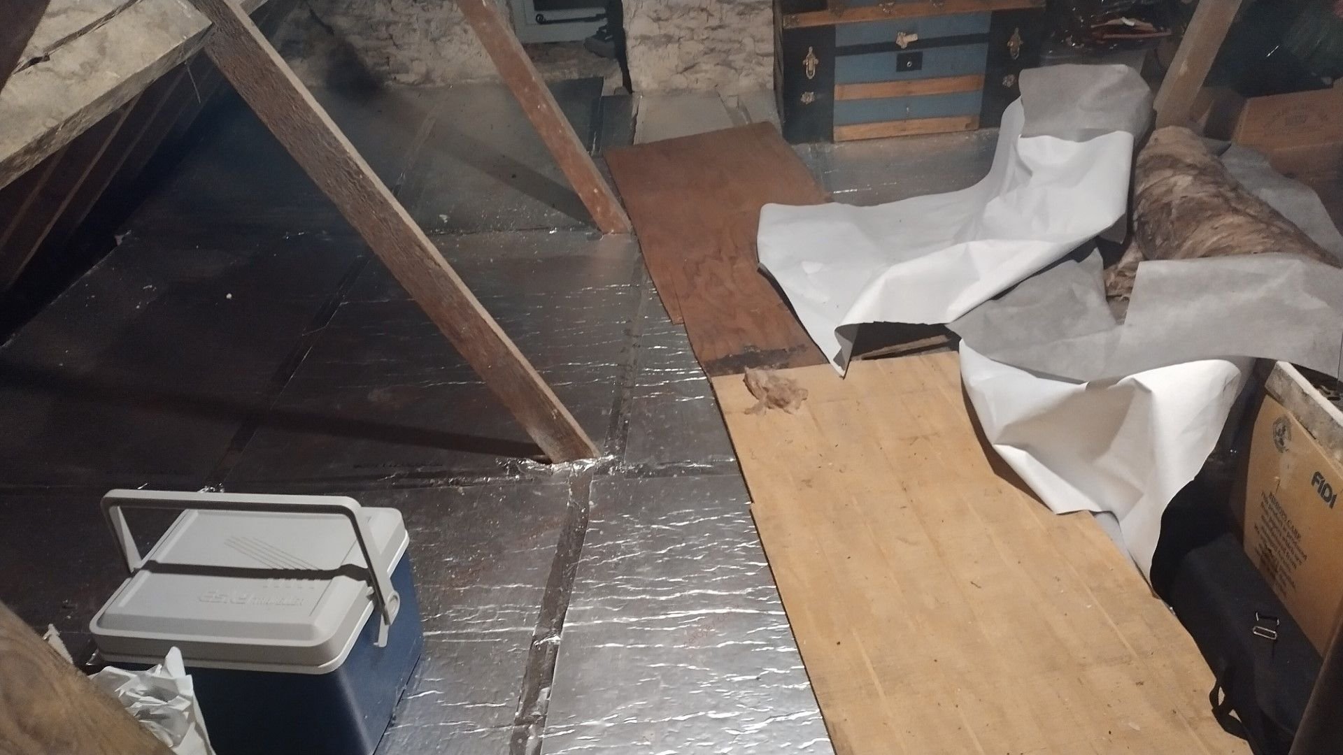

worst thing about my bungalow construction , build circa 1990, was the cold bridge, outer skin of bricks stops at soffit , inner blocks carry on up to ceiling height 175mm one course of blocks , zero insulation there and the cavity closed witha course of bricks for some reason , so a cold bridge l I have removed this course and insulated with celotex up to ceiling height . Also now the entire loft space has had timber battens across the trusses followed by 100mm celotex , the battens allowed for wires and pipes the original rock wool filled in between trusses , bonus you can walk around on the Celotex ! Carefully
100mm Celotex on attic floor - exactly what I did as well.

Same as my loft I see you used aluminium foil tape as well , I had to cut sheets length ways to get them into the loft , rough cuts but put back together for perfect joint
