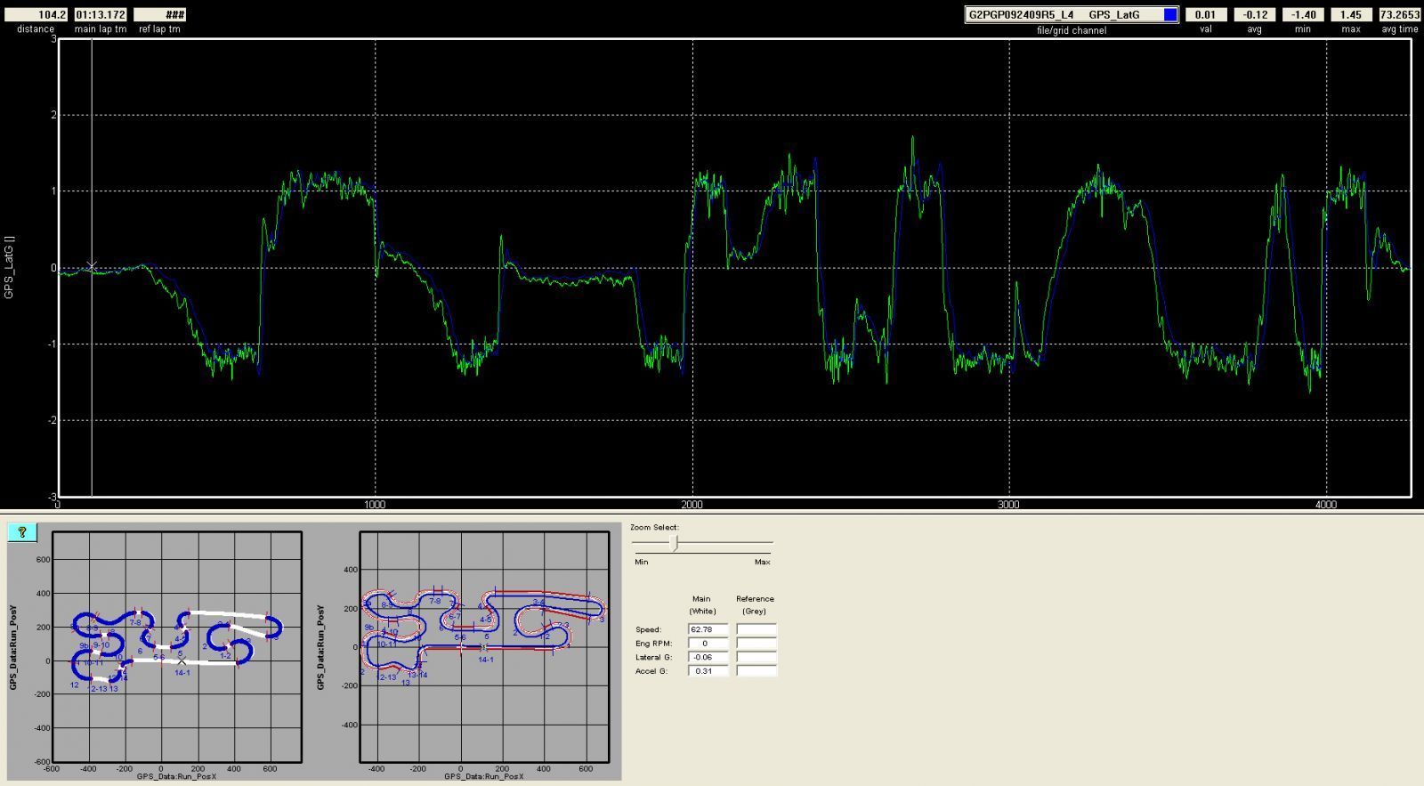

Some STR relevant data to share:
While lapping at the local shifter kart track (Pacific Grand Prix – PGP), which is essentially a newly asphalted auto-x course, I ended up running my street tires (usually run V710’s or R888’s).
My car is fairly representative of an STR car although some mods would be illegal but few of them would make a difference in lap times. The car is built for auto-x (SM2 because of 4.4:1 final drive) and track. I was trying out a new spring set-up. I typically run about 200 lb/in higher rates in the rear and no rear bar. For this session, I ran 1000 lb/in front and 800 lb/in rear with stock ’02 bars. Car was pushy (you can see and hear the steady state understeer in the video) and had a bit of inside wheel spin. The RE070’s are my street tires and this is the first time I’ve tracked them. I was impressed. They held up well after five 10 minute track sessions, being pushed pretty hard and sliding around a lot on purpose.
Data below:
Accelerometer Based Lateral G’s (No filtering, 100 Hz sampling): Left Max: 1.65, Right Max: 1.72
GPS Based Lateral G’s (No filtering, 100 Hz sampling): Left Max: Left Max: 1.40, Right Max: 1.45
PGP lap times with other set-ups:
1:10.9XX – 225/245 V710’s on 17 X 7.5/9.0 (tires 2 years old and corded later that day), Springs 600F 800R, ’02 front bar, no rear bar
1:11.201 – 255 X 4 R888’s on 17 X 9.0/10.0, Springs 1000F 800R, ’02 front bar, no rear bar
1:13.172 – 225/255 RE070’s on 17 X 7.5/9.0 (OEM S2000 CR tires), Springs 1000F 800R, ’02 front bar, ’02 rear bar
I think running 255’s on 9.0” wheels all around, removing the rear bar, and running either 800F/1000R or 1000F&R springs would be very fast.
