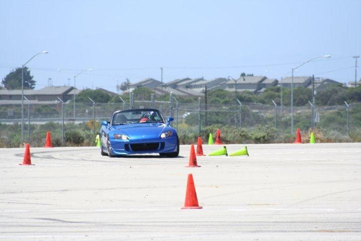

I have J's racing lower ball joints. In the picture below you can see that the tire rolls over onto the outer edge of the tire. If i put the bar on the 3rd hole, i exsperience coner entry push.

Originally Posted by Random1,Sep 28 2010, 07:55 AM
When the car roles you get more camber.
These cars definitely lose camber as they roll - not how you would typically see with a MacStrut car - but its because of actual body roll, not the suspension design.
