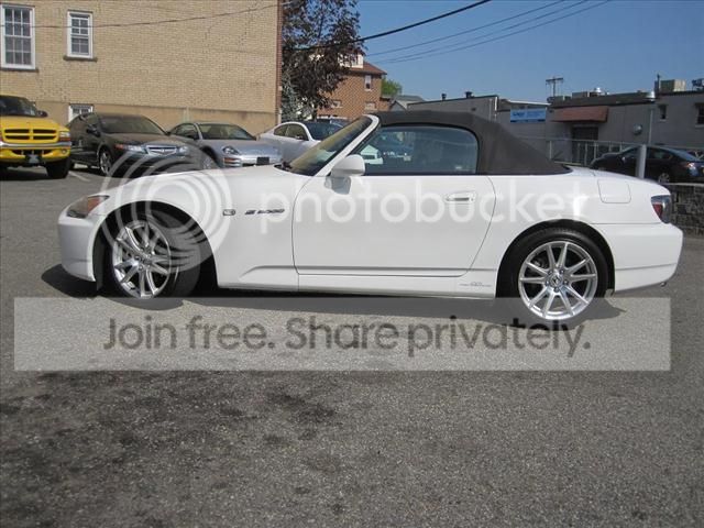

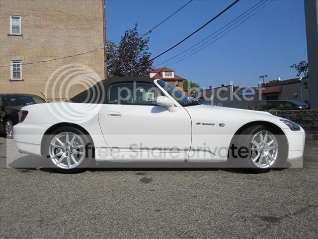

Looking at a nearby GPW\tan, 2005. Looks clean with the exception of aftermarket hood. Low miles and overall great shape. Single owner and 2 accidents on car fax, as follows:
1. Accident reported: Involving right front impact , It hit another motor vehicle
2. Accident reported: Involving rear impact
Looking at these pics I noticed that the gap is larger between the front end of door and front fender on passenger side when compared to driver side, is this something I should stay away from? Or maybe its just the angle? Car is a little over an hour away, wondering if it's worth taking a look. Independent joe-blow dealer has it priced at NADA dealer\retail value for year\mileage.

That's definitely a fix where the door is, the gap is wider than normal

My guess would be that the front end damage involved the right front fender as well, and the new fender didn't get installed with the same precision as the original. So that may not be something that I would worry about too much. The fender mounts can be loosened and the fender adjusted. What I would be more worried about would be what, if anything, of the damage to the front end I could see from under the car or from the engine compartment. What the imprecision may represent was damage to an inside body panel (that the fender is attached to) that was not replaced. If inside body panels were damaged then maybe there are alignment issues with the suspension. Before I would proceed with this I would want to know the full extent of the damages (with pictures) and the repairs that were effected. I don't like the fact that it is a dealer that is selling the car - this means that the original owner who had the accident has passed along any continuing issues to a purchaser from the dealer which may not make themselves known until after the dealer's warranty epxires. Was this the dealer that repaired the vehicle? Lots of potential issues here which may be resolvable or not. I wouldn't buy unless they can all be resolved.
It is for sale at a privately owned dealer like 'Joes Auto Sales', meaning the car was most likely picked up at an auction. I don't feel comfortable buying a car without a clean car-fax either but it is not always indicative of a bad car; my AP1 was involved in verrry minor incidents, one in which another car turned into my lane hitting my right front corner (very minor body damage) and another where I found someone brushed against my car while parked at work..police came for both incidents and on my carfax were 2 accidents. I do not plan to re-sell my next S2000 so I can care less about re-sale value once its in my hands..what does worry me is not knowing exactly what happened and if the proper repairs were completed; potential frame damage and alightment issues scare me especially. And I don't think the car was dumped by the owner because of issues related to the accident, the dates of the accidents were included in the carfax 03/10/2006 and 09/07/2007 and the original owner did not part with it until march 2012.
