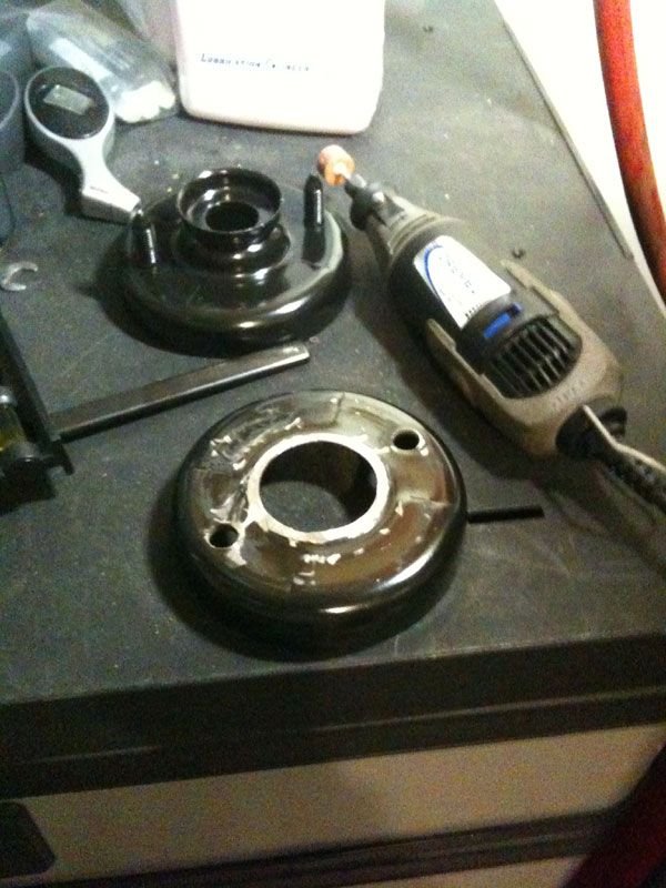

Speaking of top mounts. Maybe I missed some posts but I have some questions.
Ground Control and KW CS are both available, with GC being taller for the OTS Konis, and one version with Poly and the other with a bearing. Apparently Guy A. is developing a s2000 top?
I always though that shocks didn't need this, but reading here and reviewing the design it does look like there is some lateral movement and some vertical hysteresis.
Would a GC bearing top mount (with a torrington at the base of the spring) be ideal to eliminate any issues?
