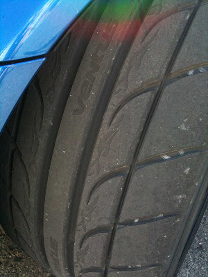

Originally Posted by imstimpy,Jun 19 2010, 03:04 PM
This will be my setup for the first event:
Moton Clubsports
anti-roll bars F/R: stock/none
ride-height F/R: 34cm/34.5cm (13.39"/13.58")
springs F/R: 700#/550#, 7"x2.5" + helpers
toe F/R: 0"/3/16"
camber F/R: -1.8*/-2*
Two drivers, 11 runs with 5 min between runs, both drivers in the car for all but two runs, unsealed asphalt, ambient temp of 95*F:
You can see some slight beveling on the outer rib (the one with the flames on it). It is only present on the front tires. Pressures started at 32psi F/R and we let them creep to 35psi F/R. We attempted to spray with ice water twice and both efforts resulted in an increase of sliding, power oversteer, corner understeer, and braking distances.
The car drove exceptionally well for a first setup attempt. It exhibited mild understeer with controllable throttle steer. Lift rotation was stable and oversteer was easy to catch (or induce). VTEC did not unsettle the car nor did lifting in 1st mid-corner for a shift to 2nd. I encountered fuel starvation in three places following big left-handers while my co-driver did not encounter starvation. My steering was more abrupt and my lines kinked. Starvation happened at an indicated 1/3 tank.
Results can be found here.. My car is STR 79/192 and driven 2nd heat, Jason Minehart is XSTR 86 and drove 1st heat, and Dan Pedroza is DSTR 86 and drove 3rd heat. Dan drove Jason's car for the first time after Dan's competition CS runs. Jason is still on his original Toyos but believes they are falling off.

More pressure. Should be up near 40lbs - especially with that little camber and roll stiffness up front.
You need heat. Don't spray them unless they go over 130-140deg.
If there are more than 50runs on Jason's tires then he's probably losing about a full second off fresh Toyos.
